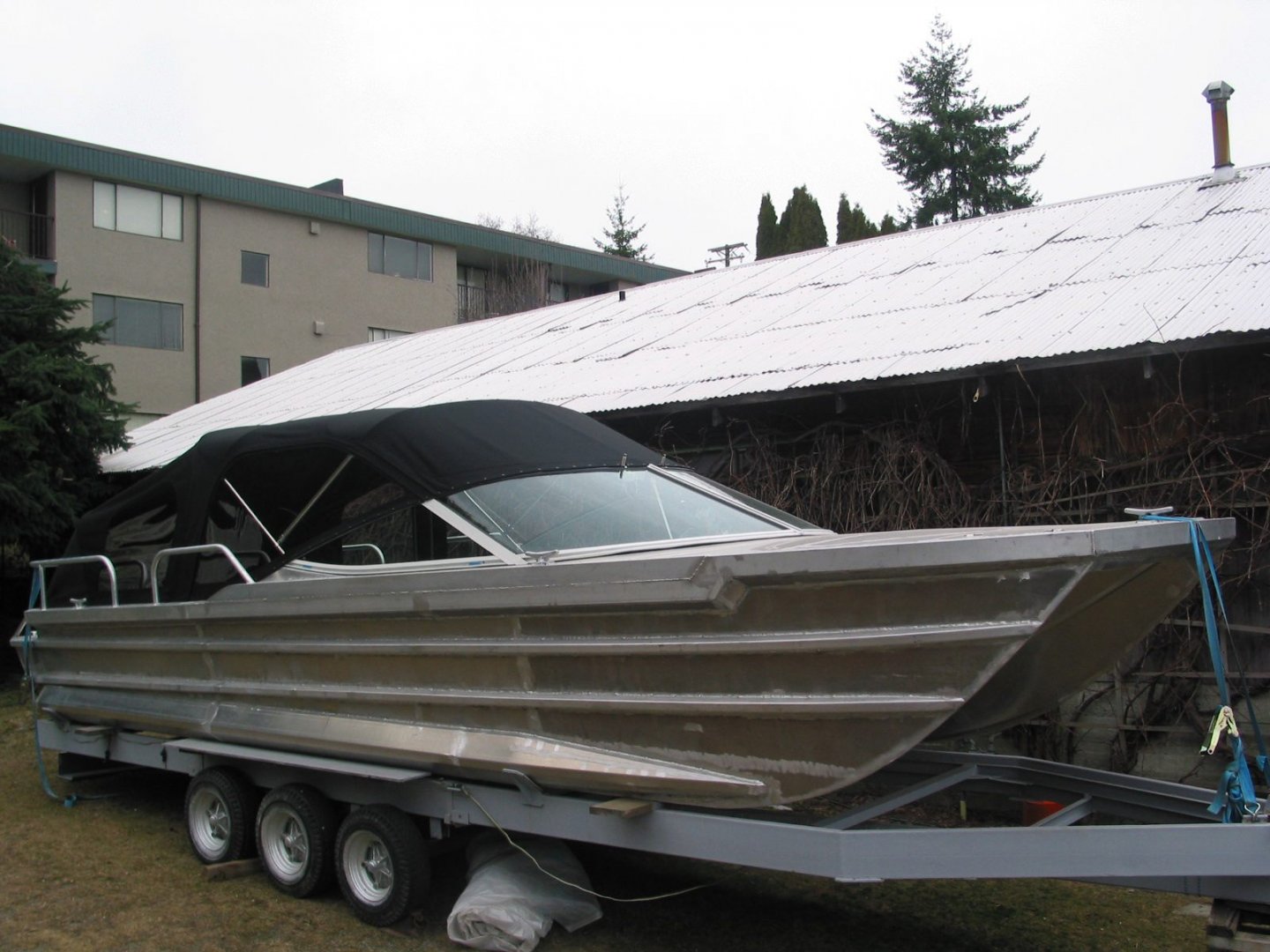

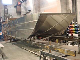

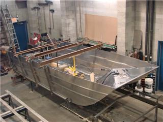

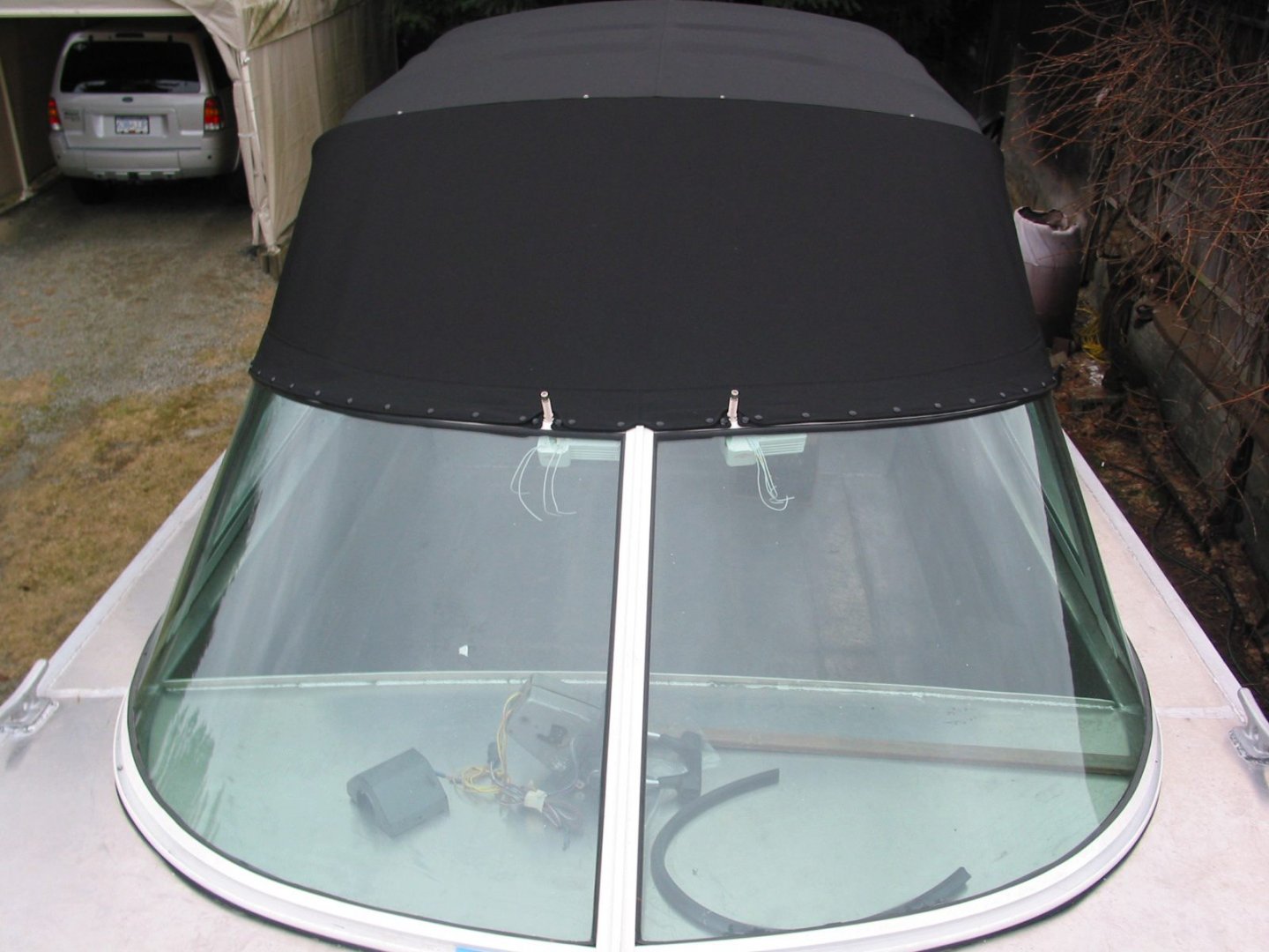

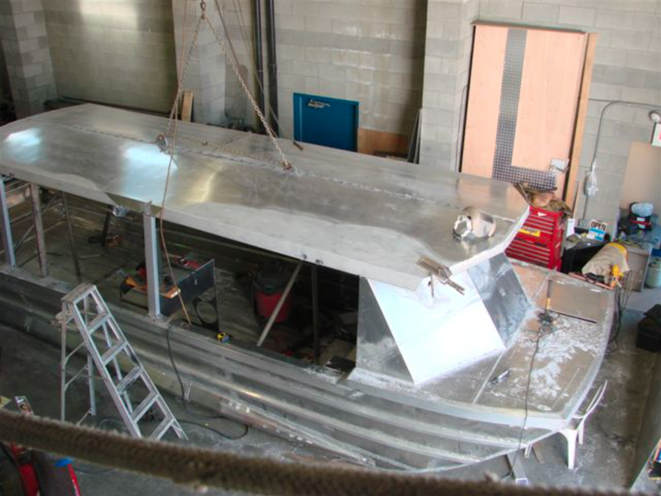

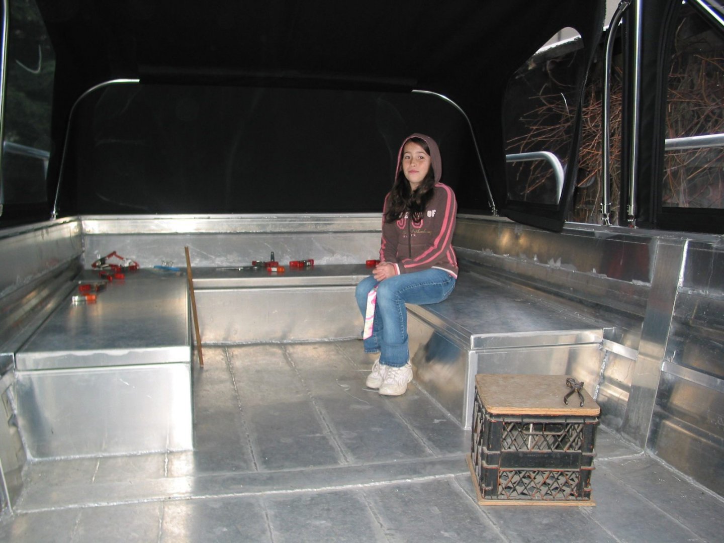

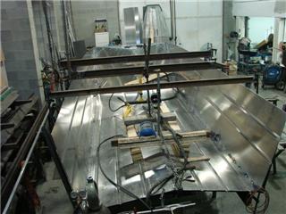

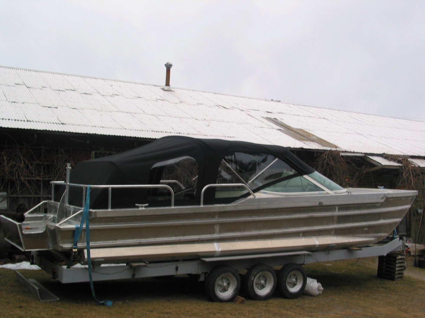

    new top 004.JPG new top 003.JPG new top 002.JPG new top 001.JPG 003.jpeg 002.jpeg 001.jpeg image.png
    From Robin777.
    A brief description of his boat in heavy weather:
    I did run for two seasons with outboards, 225 opti s
    With the optis quite close together, and I mention this because the inverted V goes all the way aft on my boat.
    When trimmed up it did porpois, Flat is what it likes.
    Load carrying is interesting, Initially I had a very forwards mounted hard cabin on her and it did not like the weight forward like that.
    You have seen the pictures of the soft top and how I changed it to be quite a ways back compared to original and I could never over load that boat.
    My family packed enough food and supplies to camp out at our cabin on Valdez Island one year and we had two adults and 5 kids with all ...... of our gear onboard and full fuel tanks under rear seats and Nothing slowed that thing down.
    we had 6ft seas and we were running at half throttle and stayed nicely on top at 22 knts. Opening up with all the kids onboard wasnt really an option but at 22 knts it saved the day because when we slowed down the kids started chucking their cookies with the rough water.
    Sorry to not have more precise data, more anecdotal in nature.

    So the inverted vee goes all the way back with that one, it would be interesting to see how different they are. I wonder if that is commonly done, I am thinking not. Interesting way the chamfer to the slab side was done there.
    DogCavalry likes this.
